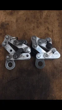

Received 150' feet of Teufelberger Xtatic this week. Tried it out yesterday - it's an excellent choice for the BDB.
Only complaints: It can be a bit "wiry" like HTP after it's been climbed on, so that's a bit annoying when putting the rope away, but not a huge deal. Also, I ordered this rope from Bartlett and they sent it to me coiled up inproperly. They set it coiled up like an extension cord (just laid the rope on top of itself, clockwise), if that makes sense. So, I had a hell of a time trying to uncoil the rope because it had many, many twists in it. Still working those twists out, 4 days later. The stiffness/static nature of the rope makes this even more of a pain. Also, to secure the coil, they electrical taped it in 3 different spots, and they used tape with adhesive that ended up leaving sticky residue on the rope (infuriating). That's all I have to say about that.
Anyway, love the rope regardless of how it was delivered. Love the color and performance. Highly recommend it.

@wyatt spruck , have you tended any other configurations than the one you've pictured?
Yes.
I've tended by directly clipping to the hole in the spine, the D ring on the upper arm (on the non-adjustable upper arm assembly, that is), and also from the nano swivel (does not work very well at all).
This method pictured is my preferred method. I clip another XSRE on a chest harness (dyneema webbing loop, 8mm x 24"ish) to the XSRE attached to the spine of the BDB.
Yes.
Co ol..you inspired me to attach my mini Stein biner I use on my chestie to the spine hole tending point and wow I was impressed. Single line of course . When dual stationary lines are in use a still need the flexibility the bungee tethers fromthe top. But wow the little biner to the spine hole for the win today! Say that five times fast ! Lol.
