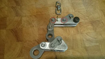

I want to add a small swivel on my bone. Before I ruin something I'd better ask: is it just to remove the two cotter pins (marked below) and then just punch the pins out where the cutters where?
I tried it yesterday but the pins/links or bollards was really tight. Didn't move any....
The snap chain link will release when you remove the one to the right. You'll need to undo the second and third one from the right as well in order to remove the stainless chain link.
Understood Tomi. The cotter pins was easy enough to remove but the links/pins was stuck. I gave the left one a gentle whack with a hammer but no movement. Should I just give a try again but harder?
They should just fall out unless something is new with the latest version. The pins are welded to one side plate and loose on the other. The plate should fall out if you remove both cotter pins on stainless.
So the pins are welded on the back side? That's explains it. All three cotter pins it is then. I just removed the two marked in the picture.
Thanks again Tomi. You probably saved my bone from destruction.... :-)
