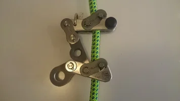

DSC_0001.webp Just before Christmas it has arrived! Some thoughs from the customs who asked what this thingy was. Well, it's for SRT obviously, I replied. Did no get any further comments from them...
Hitchless Christmas! Off climbing... Well maybe after Christmas, my wife tells me...
Merry Christmas to you all!
