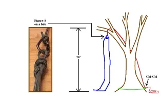

Here is a way I experimented with them a couple of times. Check the attachment. With the illustration shown you can have two static lines with one rope.
Jamin...so, in order to use both foot ascenders you have to setup a floating false crotch, right?
I can see how this works but I would rather just use a Tree Frog system which is a bit simpler.
