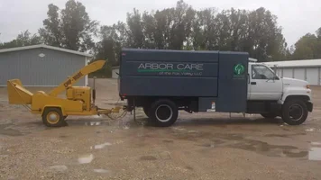

311542_10150324959493409_64756098408_8238160_1251103193_n.webp Some of that looks like the early 80's Chipmore that we used to have. Definitely a Frankenstein machine there.... but thats common with old chuck and ducks. When our knives used to get stuck, I used to hit the wedge with an air hammer and then work a pry bar into the gap in between the wedge and the drum and beat the living snot out of the pry bar. It was a chore some days but I always got it. Heres a pic of my baby in all of its glory.
