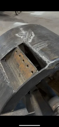

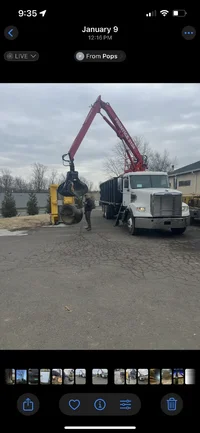

IMG_0849.webp Used the grapple truck to pull the drum out, had to cut off one bearing, otherwise it went smoothly..got the drum back from weld shop today. Will reassemble next weekend.

View attachment 100743 Used the grapple truck to pull the drum out, had to cut off one bearing, otherwise it went smoothly..got the drum back from weld shop today. Will reassemble next weekend.
What’s with the big crack on the side of the pocket visible in the photo?
Also, I don’t like that inside taper design of the drum, seems that would allow a certain amount of flex in the skin that might cause it to be more prone to delamination.
Hopefully that repair holds up well for you, and is balanced well enough to work properly!

I would rebuild a drum, but only if it was welded by a truly qualified shop. There’s a couple around here I know could do it properly. I am a good welder myself, and da fair amount of welding; I’ve repaired stress cracks on a drum, and last summer built up worn pockets on a chipper here, but I’m not putting one together like that. I’ll send it to one of the local top level shops for that.
...then turned down on a lathe for reasonable smoothness and checked at increasing RPMs for balance until it can run smoothly at full functional RPM. (That's me anyway.)
If I had one rebuilt like that, by one of the local good shops, that’s what I would expect. Maybe not lathe turned, but definitely balanced.
Idk if I said this already but a new drum from Vermeer is $11,500ish, that doesn’t include the shaft. A different company has drum and shaft available for $9,500ish..this weld cost me a couple hundred bucks.. that being said I don’t want to have to take this machine apart again if the weld fails.. I’ll get a second opinion on the welds. My understanding is the drum is held to the shaft via wedges with large bolts.. my current drum has 5,9000 hours and has never been off the shaft in 20+ years.so I’m not gonna try. Lots of wear on the drum, I don’t think welding this crack closed will have any significant bearing on the drum’s “balance”.
