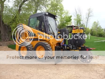

Did you say Stump Grinder Attachment . . .
You have to get a skid with high flow or . . . one of these
http://www.youtube.com/watch?v=yowFzChQW6A

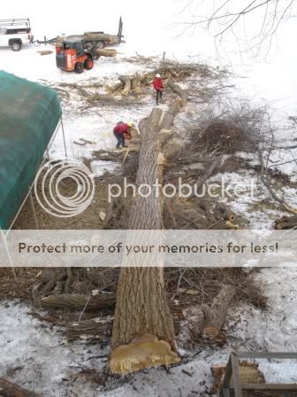

Wow, that tree was dropped onto the lake ice huh?
Cool.

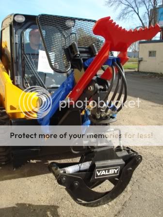

depends on what you want it to do the attachment boston bull shows is nice for grabbing and loading as if using the bucket.. whereas the arm style on the gelh articulator is for picking it up and over more like a real arm.

A friend has a FECON stump grinder on his asv, and it's the best built I've seen so far.
but someone needs to make a stump grinder attachment with the wheel slighly to the side and at a slight angle; instead of dead center and straight out in the middle. This would give the opperator so much more visibility with the cutter wheel on the stump.

My 50" full Rotation Valby with 9000# Warn winch and tree pusher is 9 grand

The grapple bull posted with heavy tines is very usefull. I have an 84" one. works well for what it is uesed fo: collecting up branches,ripping roots and stumps loading logs and piling them. The skidder type grapple is great for dragging and end loadin and much better for feeding chippers. the right tool for the right job.
