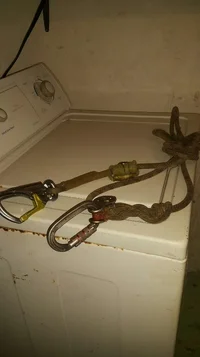

I purchased the tibloc for 25 a week ago and got to use it over the weekend. I would not use it for ascent but for this thread it’s super easy and quick to put on with a petzl roll clip for a 3:1. As mentioned though for cheapest a prusik. Btw the tibloc did not pick my 24 strand
