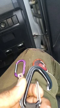

Breaking mini carabiners on footloop of SAKA mini?
You gonna use something stronger to connect to the foot loop now?
I may switch the bottom biner to one of those slightly larger Metolius-looking ones, but right now I'm going to keep an XSRE on there and see if just girth-hitching and or making a corner trap solves it. I'm sure either of those will, but I also would like to get a minute of footage and see if it's something I'm doing to exacerbate the issue too.
Haha maybe I'll regret it but it's difficult to see how - I could probably spend an hour climbing with any one of you dudes and double my knowledge.
Maybe use the little 4kn for the bungee and get something beefier for foot loop... looks like Swingdude is using the 22kn on the foot.
4kN break is 880 lbs break. 88 lb WLL at 10%. I agree to put them on the bungee, and not the foot strap side. I use 25kN for the foot side and some really small cheap aluminum things for the bungee.

Regular ol' girth hitched the biner on the foot loop - works like a boss. It is held very securely in place, preventing it from changing orientation.
