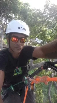

Yo it is a chest harness with sewn tending pt for xrse biner. It is adjustable. I havr been making snd selling them for $50 shipped since 2012. They exist in every corner of the globe practically. Look closely....2019-08-24 21.01.34.webp
I started with a neck style tether for tending but I just didn't like the idea bc I broke my neck a few years ago so I made a chestie just like swings. I like it but I'm gonna support him soon and get one from him bc mine is heavier and I definitely like the style he uses because it feels so good and you can make it so tight that it tends so close.
Holy crap - can you tell us more about the neck thing??
That is a mouthful. I think these things are overthought. Please get rid of that tender crap and purchase a genuine chest harness. It takes all the slop out of tending your chosen climbing system. I make them and was the first to create a lightweight alternative to the one's available in 2012 specifically for arb industry. They were big and clumsy then. Since mine many have been made for production. It is a game changer. That xrse tending spot in the pic makes a huge difference and is in the perfect spot.
