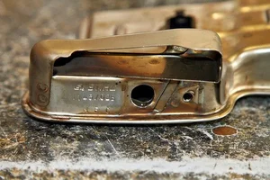

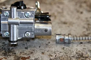

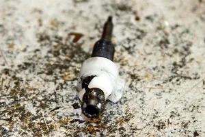

Muffler....drill a 5/16th hole at least....recommended size...I drilled a 1/2"....after you remove the nasty screen....then remove carb and use a drywall screw...to remove limiter...in the H...that will expose a 5/64th hex nut in plastic sleeve that is now your H adj screw...open that out...till saw 4 strokes then turn back in quarter turn...do this with a warmed up saw and in wood under load...small quarter turn increments....find saws sweet spot...IN WOOD...you will also have to do the L to get a crisp throttle and start every time ( smaller increments CCW )...shout me if you need more info...sorry Mark but info was needed here....

With the 5/16th hole drilled...and advanced timing done....(H) should be around 2 5/8th and (L)) 1 1/8th...mine were more but I had bigger hole and advanced my timing more...my saw ripped sold 2 200t's that were not that old because I never used them...loved that saw till I sold it...still running but dude says it's too loud...but twit does not wear ear protection...go figure...I want the damn thing back...but sure he won't sell it back when I get home...
