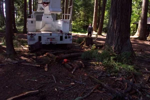

"As far as failing-
I don't feel at liberty to discuss the inner workings, though I will say that the large basal wounding (approx. 1/4 of circumference or so), and proximity to immovable "targets" (bridge, roadway, walkway) is one red flag."
So the govt keeps the TRA process secret? If i was a taxpayer there i'd be curious. as for the basal wound, that may increase the risk of it falling into the river much more than any other direction, right?
" This tree did drop a large limb off the "lean side" over/ near a closed campsite."
Branches getting overextended toward openings is natural and foreseeable and preventable without too much work; see above. Your supervisors hopefully will consider this type of work being done in the future as regular maintenance.
"It showed some decay in the upper crown limbs, but most of it collapsed on impact, and we didn't have time to look into the whole tree too much that day. Treated as an individual tree, other things could have been done here, however in the overall context of our situation, it is what it is."
I totally understand, and am not going to war over an old damaged cottonwood. It's just that the risk factors seemed hastily described at first and potentially overstated; that's all. Sounds like rewarding work and i hope the contract works out well for you guys.
BTW, I haven't been checking in much lately, in part because I've been working full time as a WA State Parks employee. This cottonwood is not private contract work, but all in-house State work. You can't see in the pictures, but the logo on my work shirt is a Parks shirt.
Sorry, I failed to mention a significant bit of background information. We did Resistograph the tree in multiple locations around the buttress roots shown in the pics with a 500mm model. Not good.

As for the basal wound, and increased likelihood of failure direction in a park campground with families beneath, it depends on the winds that day.
In the case of ice loading without wind, then yes, it would be more likely to crumble toward the river, or pull over with the lean, though at that point, surely the campsites in the fall zone would not be occupied.
In any case, public safety (with the benefit of salmon habitat restoration, approved by Fish and Wildlife) ruled out. Our legal duty is to provide a "safe" (whatever that means) environment for patrons (a challenge in newer and older growth forests)
As far as the TRA process being secret, I am sure that it is available, but I am not the Parks' representative to the public in that matter. There are outside professional consultants that work with our NR department staff with TRA and other issues.
