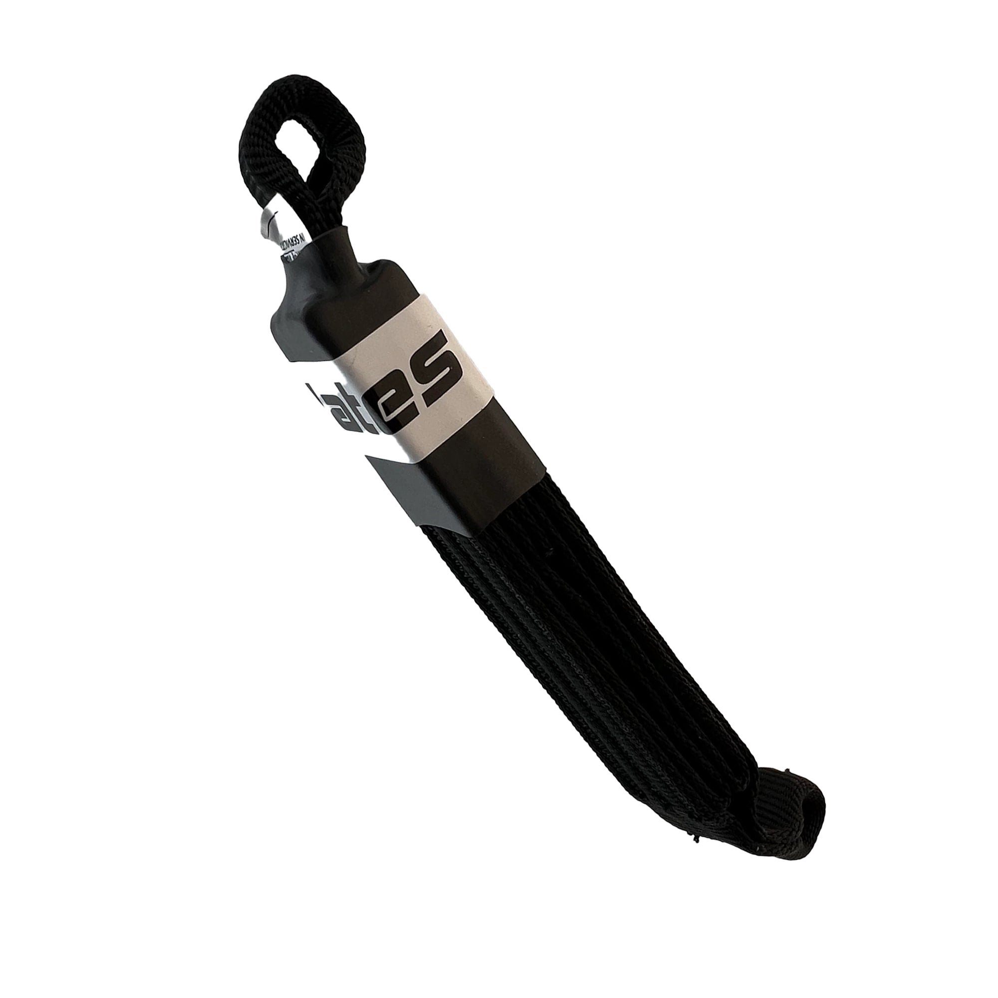

I had a bouncy kernmaster save my ass once when my tip broke. I still climb with some of the most static lines..
last wesspur order I wanted to get a few screamers, best of both worlds but they aren’t carrying them anymore….
This guy has them on the website. They say "sold out" but there is a notify me when in stock button
He does some interesting break tests on YouTube, most are for rock climbing applications but there is some crossover information.
Thanks I’ll keep my eye out there. I also want to get one and cut the middle of the folded stitched webbing to use as a breakaway
