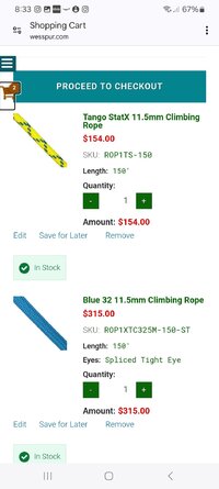

I got to see and use a 11.5mm prototype of this rope at the GOTC Rendezvous this year in Michigan.
  • Very tight, very tough and very slick cover.
  • Very dense in hand.
  • Feels much heavier than the specs listed on Wesspur's website.
  • Knot-ability is OK but not great.
  • Runs great in the Petzl Zig Zag.
  • Probably not the best for DdRT/MRS regardless of what Yale is advertising.
  • The rope had more stretch / bounce than I was expecting and what Yale is promoting.
  • Current pricing is darn silly and way too high.
Bottom line there are much better ropes out there for much less. Might be a OK rope to catch on sale but not at the current pricing.
Well, thanks. Nearly pulled the trigger just now...but resisted. The price makes no sense.
