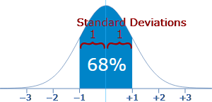

ABS/ Mean Breaking Strength is a really interesting in how they come up with those stats. Usually they use a negative standard deviation to come up with those breaking numbers, but I don't know the specific deviation that they use. So the rope manufactures are already erring on the side of caution when they say what the MBS of the rope is.
Min and Max breaking strength are typically not published numbers because they can vary a lot, and on their own they don't mean a whole lot.
The z does specifically state a breaking strength of 5,400lbs. but they dont describe how to get there and thats not what the standard is for.
