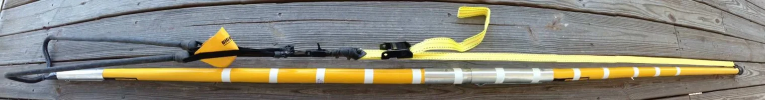

Here's what I've used for the past year or so:
Unfortunately, they aren't commercially available. This is my own design and I built it in my shop.
And, yes, I shoot it 'horns' up and out of hundreds of shots, it's never 'blown' back in my face, even when the throwline caught on something and even with the pouch twisted around three times.
There's only two in the world that I know of, mine and a one that belongs to a friend that built one in my shop last year.
Yes, but the sheet is 2.0" thick. A 1.25" hole is drilled in the center and the entire piece is mounted on a mandrel on a vertical rotary table and manually milled to outside dims and then slots are cut, holes are drilled.
Trigger, sear, and the release lever are manually milled on a horizontal rotary table using a complex jig and dims.
Probably would be ideal for injected molding techniques but I don't have an injection moulding machine and I do have a milling machine (and lathe) so.....
