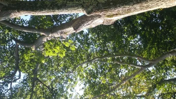

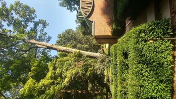

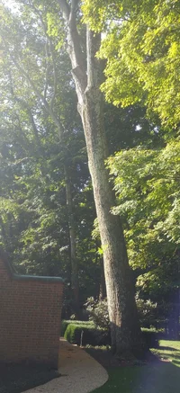

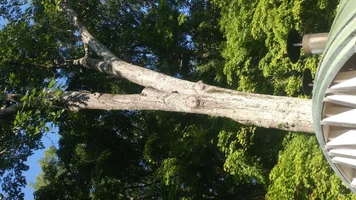

20160914_095619_HDR.webp 20160914_095504-1.webp 20160914_095704.webp 20160914_095518.webp Here's some pics of the lean and old cuts made over the house that same direction.
Mushrooms gone at this point20160914_095619_HDR.webp 20160914_095619_HDR.webp
Well we know which way the tree will collapse! We already know that wood is 10X stronger in tension than compression so I would be very concerned about investigating the tension side roots.
I am also a bit concerned about the crown, is it in decline? Looks a little thin and anemic to me.
Stop the fertilizer! The tree is covered in blue-grey lichens that are considered nitrogen pigs and good indicators of excess. This may be significant as there is some belief that, at least for Armillaria, excess nitrogen can switch decay modes and send a fungi into a feeding frenzy.

Really unfortunate amputations of lower limbs did not help the situation. I know it's harder to climb to the tips, but that's where the leverage is.
