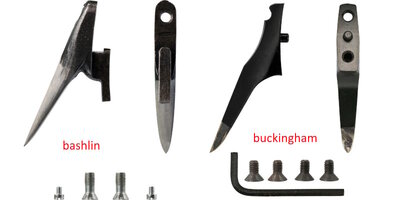

@Friedrich thanks for posting that picture. Do I understand correctly that you might have gotten those 3/4 years ago? I think those are not available new anymore.
If I'm wrong, I would like to know where they are available.
I've been recently going back and forth between my aluminum Bashlins and titanium Buckinghams. I've run the Bashlins for a few years now almost daily, the Bucks maybe just two dozen times?
On a madrone removal, I used the Bucks and didn't even think about the spurs I was wearing, they just worked. No vertical sections in madrones, lots of odd twisting angles and trunk/limb sections. But a few days later doing doug fir removals (which is most of my work) I must have spurred out two dozen times. Then going back to the Bashlins, once again, I can walk up and down firs including thick barked ones (3+") without thinking or ever gaffing out.
I just pulled up the photos from the 'replacement gaffs and parts' section of wesspur, because in my mind and looking at them in person they look very different, but these photos make the final 'working point' angle seem essentially the same. I'm not sure if that's just a photography trick and the actual mounting on the shank changes the final 'entry angle' but they sure do preform differently. For me at least.
I should throw an angle gauge on them to actually measure it... Obviously a pretty different point-shape as well.
like rico already said, i own the second type. i bought them at wesspur and last time i checked they were available.
