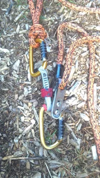

If I were going to use a Spiderjack without a spliced eye I would set it up with the new modifications. What I did instead of buying that new aluminum piece that holds the short webbing sling is just sewed the Velcro piece closed around a short stiched webbing sling (quickdraw).
