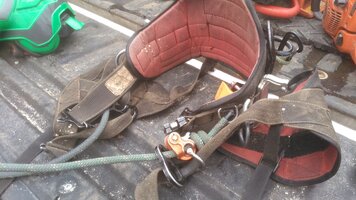

This is how I have my 2 bridges set up, before adding the roll n lock with zip ties. Do you have a picture of how yours is set up?
I will break out my 8,000 dollar camera tonight and get a shot for you. Unlike the rest of the world, I still do not own a cell phone, with or without a camera built in. My only phone is connected to the wall with a cord. Got to love those Princess Phones, they keep on going, and going, and going. A good 50 some years old now. I hear there is another person some place in Nepal that doesn't own a cell phone too, but he may have gotten one by now. Information from there is kind of sketchy.
You are / I am in luck! I didn't have to go through all that. I found a shot on my computer I had taken when I set it up originally. Just had to do a little cropping of the file. Looks better than it does now anyway. Plus it is out in my truck, which is 15 below zero at the moment.
That had to be about the second or third day of climbing with this harness and set up because I see I had a hank of Double Esterlon for a bridge. Nicked the orig with the saw a couple of days after I got the saddle and made a makeshift one with some unused rigging rope.
Is that the Weaver suspenders you have on yours? That is what I am using. They work fine.

oh perfect, thanks. Does it have any orientation issues in that setup? Seems to me like it should be turned 90 degrees. I definitely like the look of that more than with the roll n lock...
Yes I just have the cheap weaver suspenders since 2018, I like them.
You have to remember looking at that photo of mine, the adjuster is going to rotate 180 degrees on that ring and be pointing upward, not down as it is in the photo, and it can slide to the side on the ring and point just about anywhere the bridge is being hung from.
