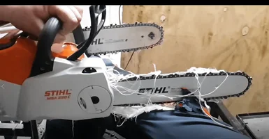

I really want an electric top handle, and didn’t realize until this thread that makita is a real contender but Food for thought; chainsaw pants/chaps may not be as effective. I’ll have to dig up the video but it was from wranglestar on YouTube doing a test on some cheaper ($40) chaps.
We heard the rumor here at Clogger as well. We borrowed a MSA220C off Stihl and did some testing with it. You will be glad to know that our trousers/chaps perform exactly the same with the battery saw as they do with the same sized petrol saw. I obviously can't speak for other brands of chainsaw protection but ours definitely work!20200114_133406.webp20200114_133449.webpMSA220C Sprocket after C8 test.webp

honestly I didn’t take the review very seriously. The chaps were obviously cheap and it was an anecdotal backyard experiment. I just saw another test, I think from arbortec, that also showEd their pants worked great against an electric saw.
Awesome test.
It's something we have been meaning to clear up for a while as we have some arb companies here that have apparently banned battery saws as they didn't have proof that chainsaw protection worked with them!!!
