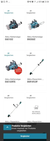

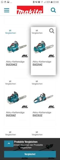

These are all the top handle saws I can find on the German makita website, they dont seem to be available in america...
They also market them specifically as pruning saws for arborists.
