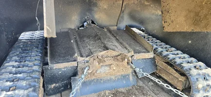

This morning I added a piece of old rubber bed mat to add to the undercarriage protection will see tomorrow how that acts and some danger flying debris signs on the wingsIMG_8308.webpIMG_8307.webpIMG_8310.webpIMG_8312.webpIMG_8315.webpIMG_8311.webp

For owners I added this sub mid mount rubber mat and put through the paces today on couple descent sized stumps awesome for keeping the chips contained way better then stock set up easy to add on mod
Kept the cookie crumb trail to minimum as well !!!IMG_8338.webpIMG_8335.webpIMG_8334.webp

My subcontractor has this grinder. He's coming from a vermeer sc60tx and he loves the bandit.
I don't have any pictures of it, or know if it's custom or an available mod, but he added a cylinder and mat over the carriage. As it builds up with chips while he grinds, he can press a button and it dumps all of the chips forward towards the wheel. Like a little flatbed dump.
I have never heard of that modification, but I am intrigued. Any chance you can find some pictures of it? I would love to see those, and perhaps make my own version of it.
He said he is running it off of a diverter valve off of the blade. . The outer edges bolt on, allowing them to come off and narrow the tracks for going through gates.
Looks pretty slick
It seems to work very well. He has a lot of time in it in from conception and trial and error to now but he's 99% done with it and likes it. He plans to replace the diverter valve this winter with an electric one so all he has to do is flip a switch. Currently he opens the door and operates it by hand so that the remote function for the blade operates the dump.
I love it! Sure beats sticking your foot in there all the time to clear that thing out before going to the next stump. Only change I would want to see is making the wings foldable somehow, so you don’t have to unbolt them. I might have to get creative someday.
That's exactly why he said he added it, to prevent leaving a trail when going from stump to stump.
I could see folding being nice, however it also leaves an opportunity for one to get hinged into an upright position and to hit the grinder when you actuate it. Perhaps a thin sheet metal or a reinforced plastic and a couple of pins to remove it?
Seems there has to be a way to do it. Or maybe make the side flaps of a heavy rubber of some sort, something like a horse stall mat, or one of those stiff mudflaps? Something that has some give to it that the tracks can push in, but won’t bend too much when flipping grindings? Has to be an easier way, just not sure yet what it is.
