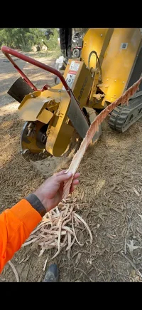

That machine really does fly through the stumps. I’m curious, which wheel/teeth did you choose? We use Greenteeth, which cut real fast, but also throw a few chips all over the neighborhood on occasion.
The black looks nice, but I don’t like black machines because black shows dirt too well.
Our RG80 with Green Teeth out cuts the SG75 with the New River style wheel by 40% or better.
I got the new river
Always been green teeth fan
It does seem to contain chips pretty well with this setup , which is of the higher of importance level for us as I work in tight urban environments frequently where trees are near high value targets to keep safe / clean. Setups with chip containment improvement ideas are always welcome.
This machine eats them chips up under I see and requires a lot of cleaning under and around tracks or it will dribble debris wherever it walks for awhile I’ve noticed.
I got the new river
A trick to minimize chip dribbling - drive the machine forward into the chip pile before backing up, then back up, drive forward at a slight angle onto the pile, then you can kick the chips loose that are under the machine. That’s one of my biggest complaints about the machine, the way it holds on to chips.
I’ll give that a whirl
