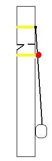

I think Reg has a good idea with letting the rope run from behind but it can be done without the lags.
