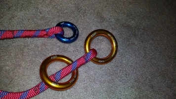

What about these rings? Any known issues? What about the isc rings wesspur sells? I was going to order some of those.
Just my personal opinion ................
I don't know why you would NOT trust the rings illustrated.
They are marked with ratings, and have Vendor info stamped on them. These should be easily traceable (phone call) to AMP.
I certainly trust ISC gear, & have lots of it.
The old "infamous" Kong ring that failed years ago, was not marked. (I was on-site when it failed.)
"Un-marked ratings" was fairly common on many pieces of gear at the time.
That has all changed.
Personally I only go with steel rings on my ring to rings, as I bomb them (sometimes with the tree)..
He just drops the ring-to-ring from the TIP to the ground. i.e. no control of speed by using rope, throwline, etc.
It then can hit rocks, etc on the ground. (dingles, dents, sharp burrs, etc can result)
I have a couple steel ring-to-rings, which I have bombed. Just make sure you still inspect them.
Again, I don't think my 145lb. frame will ever generate enough force on a ring to break it.
I think ya'll are worrying too much.
