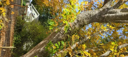

The resorcinol glue bonds like a bugger, you can apparently boil a bonded joint in a pot and not wreck it, goes to -40 deg - that's why it's in a class of it's own. When I saw that perfectly clean, non splintered crack that would contact back together like a glove the light went on. I've repaired wood joints where the irregular wood faces fit each other.
If you visualise the shifting of the shear crack faces against each other under storm jostling (even after bolting) it seems you can only improve the overall structural strength by re-bonding the faces and removing the source of flex - back to like it was before the crack. Like in carpentry, the glue is likely to work so well the (screws/staples) bolting becomes the backup. And rightly should remain in place.
Next time a hurricane mangles the tree do a post mortem to see if the glue (stronger than the wood) failed or the wood failed, or it aged out, was incompatible rot set in, etc. But my bet's on success (boats!!).
