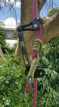

Has anyone tried using a wooden ring/donut above the hitch knot, to alleviate binding? When hitch knots binds, I would think a wooden donut-like ring would mitigate the binding problem by giving the climber something easier to grab onto to pull onto the hitch knot, especially on descent. I seen them being used with rope grabs on lanyards, but never with a Rope Wrench or HH2. I suppose it would be nicer if such a donut/ring were mid line attachable, but either way would probably work.

I believe @Brocky and maybe a couple of other people use a system like that, although I am not sure that it is because of the hitch binding.
Second smallest x ring ftw:
