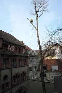

Here's a view from the top of the tree into the drop zone and the working zone. As you can see it's not a ton of space and the pieces being rigged were sizeable.

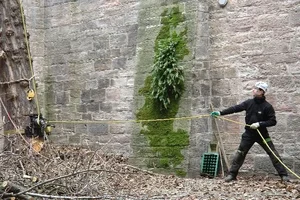

GRCS attached with the visor, with Pascal - the star groundie of the day - in action...

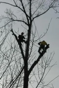

Looking up the tree. We started a eight, by ten, when Lucas took this pic, most of the long limbs over the building had been removed.
It was a squeeze, with windows and old tiles all around. Combine this with brittle poplar limbs and you have a sure-fire receipe for a fiddly fell. Most of the time we were balancing limbs to avoid the load changing it's orientation and having branches snap and to avoid shocking the stem, or at least to reduce shock loads.
By the time we got this far it was pretty wibbly wobbly. Due to the removal of the side branches the structure of the tree looses it's natural shock absorbing system (i.e. the braches) and starts to move more - or differently. As a matter of course for this reason it can be a good idea to remove part or all of the top before removing the side braches.
In this case it wasn't possible due to lack of space. So we had to be pretty cautious rigging down the top. Nice, smooth and dynamic lowering. One of the moments you appreciate a good ground crew!

Working the top. Bit tight for two. Up until then we had been using two lowering systems, lowering front and back. Just speeds things up a bit, and stops everyone getting cold.
After this Serge carried on and I went down.

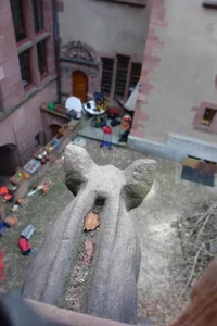

Now you're probably wondering where the gargoyles come in.
Weeeell, usually, once the branches and width are down, the most difficult part is done. After that it's lowering the heavy wood. With the GRCS, no problem. Nice and smooth, dynamic lowering gradually braking the bits before they hit the ground.
Not here. I mentioned the gargoyles before? Here's a pic of one...

So, when I was lowering the top bits, I took a bit about body length, maybe 40cm dia. Poplar wood, I reckoned it'd weigh in at about 180kg. We had about 15 meters to drop it into. Pascal took one and a half wraps on the friction bollard.
The bit was a bit heavier than estimated, smacks the wall and just misses one of the gargoyles. Whew! That would have been our profit of the day down the drain. At first I couldn't figure out what was going on down below. As far as I was concerned the pieces had gone down nice and smooth. Yes, but...
I'm now officially gargoyle traumatized!/forum/images/graemlins/aaa.gif
After the job we discussed the situation. Pascal who was on the GRCS said it was his fault, not enough friction. I don't agree. As always, it's never one person in a team who goofs up, it's a chain of events. In this case, I was weighing up length of the piece vs. efficiency. Do you take one meter bits with low weight, but take into account the necessity to move the rigging system many times, this making it slow and more points for things to go wrong. Or do you choose larger pieces with more weight, but less change-overs and faster. There's a break-even point there. Make your plan and work it.
In this case I should maybe have taken into account more the fact that there was things in the lowering zone not to be damaged and made the pieces even smaller. But it was an unusual situation in that it wasn't the drop zone on the ground that was the problem but the deceleration zone three or four meters up that's usually clear to do dynamic thanggs in.

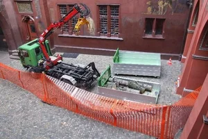

What d'ya know, me again.
A very last one: This is how council boys and gals do their tidy-up. This baby cost them € 120'000. Wow. You'd want to have it running a lot with that kind of price tag.
Still, if someone offered me one for free, I might say "yes", so maybe I'm just jealous.
