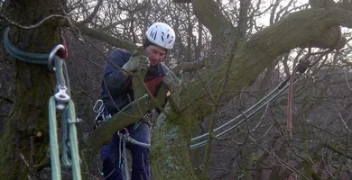

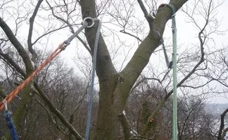

Hallo Jim.
This is a copy of my reply to Tom on "webbing false crotches". The attached file is a PDF on how to install it from the grownd.
This is the FC configuration we are using.
It's made of samson tenex cous it's flexible and it sets nice to the bark (if you use rope that is to stiff it wil eat into the bark in this config).
On one end of the tenex is an ART pulley, the ring is attached by a Dyneemaa sling using a prussic. At the other end is a little harp that you put onto the climbing line on the side were your prussic hitch is on your climbing line.
With this FC your friction is almost zero.
Let the splicing be done by a professional, your life depends on it.
Over the splice above the pully you must put a shrink wrap (this keeps the splice nice and tight and it will flip the pulley more easily out of the ring).
If you start using the device:
Don't tie the frictionsaver in the tree with a to small end to the pulley, otherwise you will end up tieing the dyneemaa prussik onto the thick splice of the pulley end and the prussik wil start sliding.
Keep it safe
Wolter
Wolter, thanks for taking time to answer my questions and for the cautions. Coupled with your pictures, I think I can make my own now. I was wondering about the shrink wrap; good idea.
