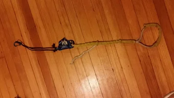

I just use a homemade knee ascender and leave it on the whole climb. It's never really gotten in my way at all and is always ready to go.
No, I'm not a "smartass." Seriously, I would like to see a picture of your knee ascender to learn how you did it.
My apologies, 1/4" amsteel, locking brummel to ascender and adjustable footloop. Put an old webbing sling around it to help with picking and wear. 20161029_190321.webp Pretty basic but it's worked great for the last couple years
