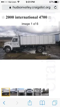

View attachment 42857 Here's a one listed today
DTS. What are the walls made of ? How are they attached ?

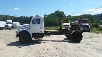

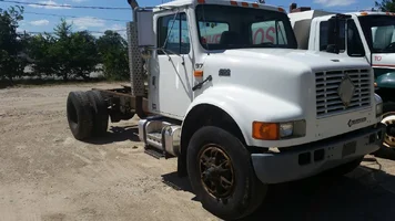

Well my truck is finally here in NY. Arrived today and is spending the night on the trailer, at the towing company's lot. In the morning I meat him at my buddies shop where the build will begin. I'll snap a couple pics and post them tomorrow after I figure out how. I'm still learning everyday. :D
I stopped and looked at the dump I had in mind and might pass on it. I'll take pics of that also. I've located a couple more choices of bodies and will look at those. One more place I'll stop and scour is an old farm with a ton of trucks visible from the road. If I see any there .... more pics. So botom line ... lots of pics coming soon.
Okay so truck is at the shop and I snapped a few pics. I also stopped at the first body and took pics but only two came out well due to the sun in my face. I looked at two more bodies. One was an old grain body with metal side and barn door. Full of debris and under a LARGE popular tree. I look underneath and see rotted cross members and punky wood decking with water dripping through. NEXT ..... a 13.5' with telescoping ram w/o a dog house. Looks solid and pump may even work.
