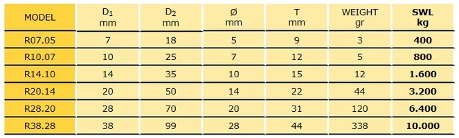

I am working, I can't wait to contribute to this thread. The more rescue man talks the more he shows what he is. Some really rediculous stuff stated now. The rings are rated by the way I will give you the chart, but they don't need to be rated and the rating actually doesn't really make a difference it all comes to whatever cordage is placed in the ring because they are a freaking thimble.
