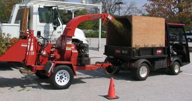

We tow a Morbark that I believe weights around 2,000 lbs. We have an electric brake controller on it for the chipper brakes. We have a removable chip box on it that can be removed by hand and dumping the bed. We take the box off to haul logs, soil, mulch, etc.

Tom,
Attached is what I mentioned earlier in the thread. We've added a half wall in the back to extend the height of the tailgate to hold more chips. Theres a piece of angle iron in the front to hold it to the bed. The handles are there for two people to lift the box up and back 2 inches, then just dump it off - very easy and quick!
We have a seperate cart for gear since there is anywhere from 2 to 5 of us out at a time but I'm sure you could figure out where to fit a gear storage box.
