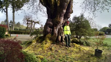

And this is the biggest tree I've ever saw around here (here being the whole freaking state), found it on lunch last Friday and had to walk over to see it.
