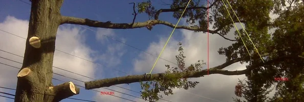

Here is Marks photo edited, the yellow lines are where he placed his slings, the red line is the CofG where the slings could be placed and the result would be the same.
He didn't tell us how much it weighed so I made up a number to show my point.
I think He did a very good job and I don't care how he slung it, the reason it didn't move is because his judgement of where to have the hook, right over the CofG.

Having the hook under the COG is standard. The point is with multiple slings you will have predictable results. Using 1 sling and hoping you are correct on placement may not be good advice if there are obsticles like utilities.If one sling was placed as you showed in the last pick the load could rotate contacting obsticles. Like others have said this technique has a place. May not be for every cut or every tree but it has it's place and Marks posting is an ideal cut for it.
I'm not trying to say use just one sling. What I am trying to say is that no matter how many slings you use if you do not have the hook over the Cof G there will be movement.
Yes if you only have one sling and you are off with your placement that sling acts as an axis, however so does the hook with multiple slings. If you are way off on the placement the pick may come vertical after the cut, but generally it will only move the same amount it would with multiple legs. If you were way off with spider legs it may become close to vertical too.

Sorry ive been away. I agree with what you say judging end for end. but that is saying both ends are balanced the same. I guarantee if I had hooked it at the point in your illustration it would not flop end for en but it would have rolle since one side of the union was higher off the ground than the other. So end for end yes but inthat situation not side for side.

And in reply to Allmark, I would use two slings. one on each branch where the red line is.
