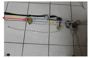

After thinking about this whole thing for what seem like an eternity, I think I finally understood how the system works (mainly the 3:1/2:1 thing), and it seems so painfully obvious now. Heres my explanation of the different phases in a RADS climb. I am going to go over the forces involved, hopefully in an easier to understand manner than *useless info*, in order to hopefully make it easy to understand for everybody(keep in mind I am only 15 years old and English is not my first language):
first of, I am going to define some terms here:
Here is a normal RADS cycle. Forces of 0Kg are not mentioned. The climber only uses the pulley to pull slag out of the rope! All the climbing is done with the legs.
1. phase: climber hangs in blocking device
The weight of the climber, in this case 100kg, hangs in the blocking device. All load is on the standing part of the line.

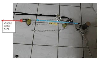

2. Phase: the climber shift up ascender. The load is the same. The end of the line is pulled upwards by the pulley on the ascender.

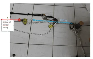

3. Phase: the climber stands up on the footloop.
All weight is on the ascender.
The tension above the ascender is 100kg, the standing line between the blocking device and the ascender is unweighted and slag builds up due to the blocking device being pulled up by the harness of the climber.

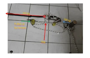

4. Phase: Climber pulls slag through pulley and sits back into his harness and blocking device. The forces and the position of the end of the line are now the same as in phase 1.
This is the normal cycle of a RADS system, if the climber only uses the pulley system to pull out slag. But thats not what most climbers do: almost all of them use the pulley system to a certain extend in order to share the load between their arms and legs. This is hard to illustrate, so I am going to assume the climber is not using his legs at all.
