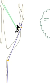

how does he stay in position on bare leaders?
like this:
X man, your two posts in this thread are probably two of the best posts ever posted on any arb forum, nice one.
it's all about the right shoes and the right tension and a knee bar is a wonderful thing. don't knock it till you try it.
