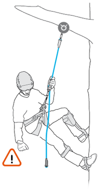

Strangely enough, Petzl is ok with that technique on the Zillon.
I kinda read it like they warn about "jerkiness" if used alone/ singly and they put in a sorta caveat about a Munter and biner (or maybe a ring and biner) below the Zillon when used like singly. Suppose you could use a Shunt above the Zillon too (too clunky?).
From experience in traverses with a Captain/ Zillon setup on Tachyon, when you get towards a shallower rope angle (still below 120 degrees) it can get "jerky" to the point where I've come back on the line slowly, in steps sometimes, with a pulley setup. With smaller rope diameters, this jerkiness or tightness is more exaggerated yet. My two cents for whatever it's worth. Personally I wouldn't rap down on just a Zillon or a ZigZag or a hitch anyway (born under the birthsign of the cringing chicken).

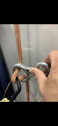

I do this above my mechanicals on long descents. It saves a lot of wear on the device.
I don't use that carabiner, it's just what I grabbed to snap the pic.

We do kinda the same with a Petzl Shunt above our ATC’s/ mechanical but for ice/ glop on the rope (wintertime ambles up waterfall ice) I’ve gone to a Munter below on my leg loop. In winter it can be amazing to see your thigh just covered in rime ice the Munter has stripped off a rope, even dry treated ones. The Shunt usually rides on a short length of sling and provides a backup stop if you let go (the whistle test?).
