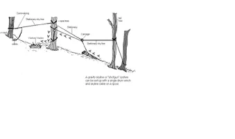

Dan, I was thinking about how you guys use spar poles as "lift trees" on steep backyards, and I remember reading a few years back about some loggers in Maine who were using a similar small scale yarding system. I did some digging in my files and found the article was in the Oct/Nov 99 issue of Sawmill and Woodlot Management magazine. This is a pretty good magazine ( www.sawmillmag.com ) and you can purchase some interesting back issues there.
In the article they talk about building a small 3-horsepower portable winch adapted to forest thinning. Despite its small size, two men could yard 7.5 cords of firewood per day from an area of about 1 acre. They called the winch "A Yankee Yarder".
Stringing a "skyline" in the air from the yarder to the wood permits running the mainline cable through a block(carriage) riding on the skyline.
To log uphill on steep ground, a two-drum system or a single-drum winch plus a spool of cable can be rigged as a gravity skyline as shown in my attachment. By the way , my wife did the drawing in the attachment using Microsoft Paint and she did a much better job than I could have done.
