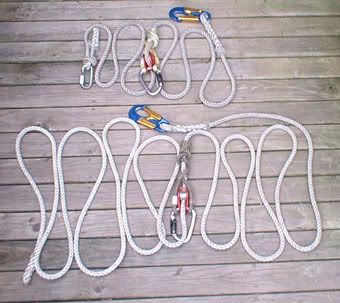

This is how i have my lanyard setup. I don't know how long it is but i think it is around 20 feet. I have a small prusik on accessory cordage to hold some of the slack and create another loop

I just daisy chain the tail and keep it pinned up with a mini biner. Only takes a few seconds to unclip it and pull a few loops out and put it back when needed.
