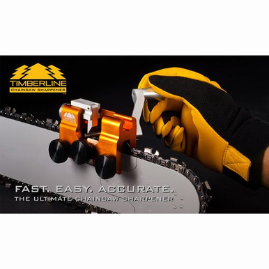

Another option is the Timberline chainsaw sharpener. It does a REALLY good job and doesn't require power, but it doesn't really save any time (It sharpens each tooth ridiculously fast, but you have to slide the chain and adjust for each tooth). I bought one because my workers just never seemed to master sharpening. One worker liked it a lot and it improved his sharpening quite a bit, but I still prefer to sharpen with the Stihl handheld sharpener. Overall, I was disappointed with this for the price point.
What was disapointing about the timberline to you? We have one that we absolutely love to use. We get great results and with about 15 minutes of instruction so do all my guys. Good luck teaching someone to hand file and getting them to master it in 15 minutes. Ours has been flawless.
Don't get me wrong, it works great and makes a sharp chain (even for guys who can't sharpen well if it's set up properly). I guess I just feel the motion is more laborious than an electric hand grinder: you have to slide the file out far enough, slide the chain forward, and sometimes tighten/loosen the knob that puts pressure on the back of the tooth for each tooth (I think the last part is what makes it laborious and is probably where the operator error is coming in. The file really shaves off metal ridiculously fast.
