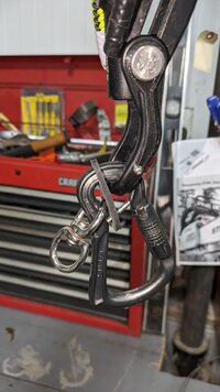

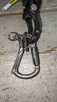

I opted for the normal swing arm and use a dmm ceros with captive bar. I have a rubber keeper to separate a hardware store eye n eye swivel. The swivel clips to my chest harness.
