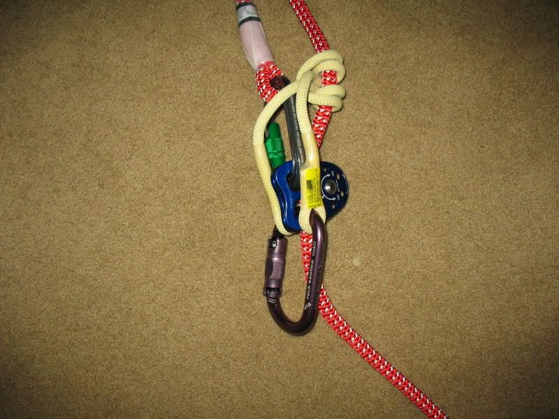

I have only climbed with a traditional system so far, but I like to diversify. I decided to try and rig up using an eye n eye tail with the pulley. I used double eye pulley since thats all I have at the moment. I decided to get out and try it quick before it rained, but something here isn't right, I just don't know what. It was a major pain to advance the hitch while body thrusting. It's not that it DIDN'T work, it just didn't work well. Is it the placement of my carabiners? Instead, should I have clipped one to my saddle and through the bottom eye of the pulley,and then used another through the top eye and also clipped through the eye on my rope?

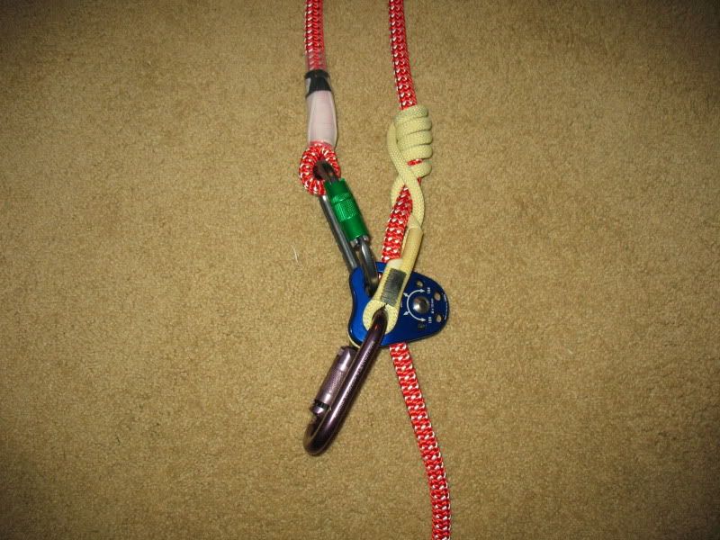

Just noticed you said its a mickey mouse type pulley, Take the carabiner that is hooked to the eye of your rope and put in the top hole of your pulley. Take the carabiner that has your hitchand put that in the bottom hole - having one eye of your hitch on each side of the plate. Make sense?? Someone may post a picture.....
Would this work any better?
I tried to give it another pass through initially to shorten it up, but then it was a major pain to descend, very very jerky.

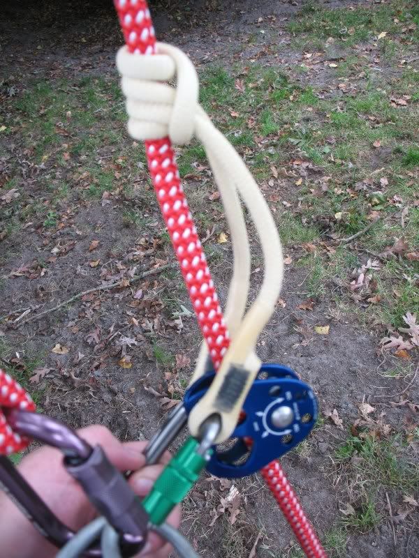

Andrew I'd recommend an XT over a VT. I'll send you some pics with a reply tonight. Just got home and need FOOD.
