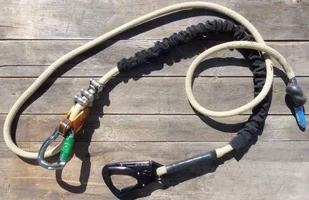

@robinia The stitched eye on the end is NOT life support. Half of the stopper knot is visible then the sewn eye. It's there to make a loop instead of having the tail drag around
The rope and cord have been replaced but this is the setup I came up with. KMIII 7/16" and New England Tech Cord
Now I leave a longer tail in the triple wrap fisherman's Tech Cord. When I put the lanyard together I clamp the tail of the NETC in a vise and set the fisherman's with some hard tugs. Seizing/stitching the tail would be an even better solution.

High tenacity polyester, a static kernmantle rope from Sterling Rope.
Stiff stuff, probably flips nicely when used for a lanyard.
