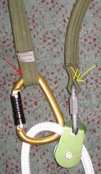

After seeing false crotches a number of years ago I made my first one. Taking some three strand rope I spliced a round metal thimble in one end. For the large end I used a plastic thimble and spliced a small figure eight. Soon after that I saw someone's FC with a biner and pulley setup. This is a much more flexible system.
New Tribe started to make variations on the FC. I bought a couple of the plain eye & eye FC slings. In the picture you'll see that they came with large eyes. My preference is for very tight eyes to keep the biner and screw link oriented in the right direction. The NT sling has the original size eye on the biner side. On the screw link side you can see the yellow arrows for my stitching. There are three lines of stitching to make a tight eye and a box to sew the large eye flat.
The yellow lines and arrows are my stitching.
The next itteration is a pretty much homemade FC. The basis is a 1" tubular webbing sling. The splice is worked over to one end and tacked in place with a couple of passes of stitches. Leave an eye about 1.5" long. Then make a small, tight eye with more passes. Box or parallel stitch the rest of the eye. Next, I run a line of stitches from the splice to the other end, stopping about 1.5" again. Run another row of stitching on the other side of the webbing. Make a tight eye in the second end like on the spliced end. Finish up by connecting the cross stitch for the eye to the parallel stitching.
The homemade FC has been in use for a while and shows little signs of wear. The stitching that I do has no added strength. For more information on sewing gear take a look at the book, "On Rope" I think the ISA sells it for about $35, pound for pound, one of the best book deals around.

This is the homemade FC.
Yellow lines and arrows are my stitching.

When making my own false crotches, I've come to the conclusion that the thicker and heavier the material (rope or webbing) the better. Light weight materials just encourage the rings/pullies to flip around small branches and permanently Indiana Jones themselves into place!
Taking a sewn sling like the blue one Tom shows and running it a bunch of times back and forth across the Singer will stiffen it up quite a bit.

Pretty slick Tom. Is the bushing pulley with small sheave diameter/efficiency leverage over turning on bushing, that much more efficient than just bushing on pin of clevis?
i maid someone an el-cheapo False Crotch/Friction Saver(?) oncet from 5/8 3strand and 2 metal, 'teardrop'(?) rope thimbles. The oversize thimble was for a 5/8" line, and allowed an overhand knot in 1/2" to slip thru it and jam in the 1/2" side. Stiffened and weighted as Nick refers too, by running the eye splices longer, and wrapping with yellow electrical tape on 1 side and red on the other. Ain't seen the guy i maid it quiet awhile. Also, the 2 thimbles had larger than the 1" support area for climbing line; than afforded by the 2 1/2" rings in store bought model (and mine more friction too quite fairly i'd imagine).
Eyesplices more tappered and carrying load down the length of the line more properly to secure bitter end, instead of at leveraged angle of conducting force perpendicular to line device in knot to bind bitter end from escape. Each (splice and knot) using the same strategy to use 'standing part' force (to stand) on the 'bitter end' to secure. Most splices feeding directly down the length of the line to secure bitter end, not choking crosswise to line axis at a leveraged angle like knot to secure bitter end; ummm as Nick would say! /forum/images/graemlins/ahhhhh.gif
