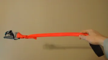

Are you still running a bungee-free knee ascender?
Yes, it's basically just a Petzl Basic with hollow tube webbing, stiffened with coat hanger wire that has its ends rolled over and stuck into the knots. Foot loop is improved with bungee cord, a piece of stiff leather and some change sleeve so it forms a good stirrup that cinches on the shoe. Only place it doesnt work perfectly is pushing up through really brushy stuff. It cost less than $60 and is still going strong.
