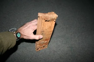

I watched a man use handhewn oak wedges last fall when I was at Katrina...he needed to break some large chunks in half so our saw could finish cutting thru them.
