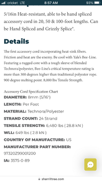

I couldn’t find a topic on Bee Line. Can somebody tell me the MBS tensile strength of the 8mm? I have a catalog that says 8000, and so did the girl when I called. But then I went on the I internet and saw it around 6400, which is what they alway said it was years ago. I called back and this time a girl said “I would go with the lower one”.
It’s quite possible that the lower numbers are accounting for a naked eye splice and about 80% of tensile, due to the locked brummels.

Probably just an error in editing. You can find such errors in just about any catalog or online site for arborist gear. I have sent emails to WesSpur, and Sherrilltree about error I have found, and have gotten emails back saying thank you, error has been corrected, several times. As an example, I just went to WesSpur and found this
WLL (5:1) / (10:1):6,600 lb / 3,000 kg
on one of their rigging block ads. 3,000 kg is the same thing as 6,600 lb. The 3,000 kg should have been 3,300 lb.
My question was more about what are your concerns with the difference between 6K and 8K MBS? Are you using the cordage for something that is going to approach those figures?
