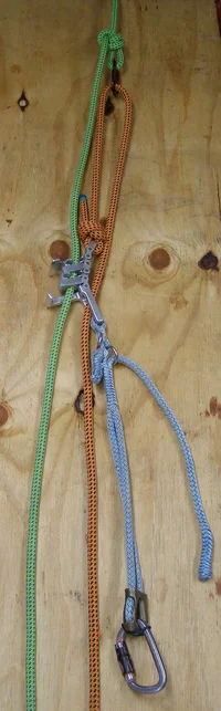

This afternoon 'Bowlegs' Bill called to tell me about a solution for one of the Unis weak points. Slack tending with the current configuration of the Uni isn't as easy as tree climbers are used to in DdRT system with a slack tender.
Adding a redirect underneath is one solution and is likely to be in the next generation of Unis.
The solution that Bowlegs came up with is to piggyback a DdRT system onto the top of the Uni. The picture is of the simplest, least gear intensive, setup.
In my picture the green Tachyon is the anchored climbing line. Before heading out on the limb an in-line loop is tied, I used a lineman's loop.Then, a second rope, or the tail of the climbing line, is slipped through the bottom part of the Uni. Next, clip a biner in the loop and clip the rope through the biner.
When returning from the limbwalk the climber can use the orange rope to yard themselves in like a usual DdRT setup. The slack in the green line needs to be tended to keep the candycane from being too long. If not, the climber would fall the length of the candycane, not half the distance like in a DdRT candycane.
I found that I could use one hand on each rope to walk back in under tension and balance.
From here, there are many ways to modify and improve this setup. A small camming ascender or friction hitch could be substituted for the lineman's loop. Add a pulley to the upper biner and there's more effeciency. Add a tail to the rope that is terminated on the top eye of the Uni in my setup and the climber would have a true DdRT setup with a self-belay.
Using the tail of the climbing rope in SRT has the same limitations as in DdRT.
-Will there be enough rope to exit the tree without a changeover?
-Will the loop of rope catch falling limbs which could lead to the climber getting pulled off their feet?
-Will the loop snag on stubs or bark flakes?
A second, short rope could be packed along for a limbwalk. The second rope would not have to be too long. If the climber were careful to keep slack out of the green rope they could use smaller cord since the slack tender setup really wouldn't be part of their life support system.

Why not just set a pulley on the green rope and transfer the uni to the orange rope.Or just leave the uni on the green rope and have a a friction hitch with a micro pulley already set up on the orange rope, maybe with a bridge extension.Set it up thru a pulley on the srt right above the uni.Then once you get back just transfer back to the uni and stuff the orange rope in a little rope bag.
There are other variations, of course. having something that is quick and not complicated is key.

I could give you a better set up then that for use in the DRT system. Just ask Jim454 about the Heidal hitch.
As for the SRT use, how about a simple pulley set to the side Dring of the saddle? Seems to me, the slack could be tended one hand, while uni will advance at bridge set?
The slack-tending thing is so different with a Unicender and depending on the rope angle the small loop on the top can be pinched and the uni will 'trail along' as friction is not an issue. Sometimes when the rope is grabbed beneath and held up the Uni will 'scoop-out' the slack.

Tending slack hasn't been a big inconvenience to me. But...I can see that using this add-on for low rope angles with long run-outs would be a good solution.
Hybrid Uni climbing.
I thought of a name for climbers who use the Uni...Uni-Flyers...whaddya think?
Really though has anyone tried a pulley to a side D ring? Your maybe attached to the outside leg loop of the saddle?
Or even better!!!!! How about a pantin on your leg loop or around knee? After limb walk you could put rope in the pantin and as you walk back it will tend rope for you?

Just finished giving clearance off a roof in a large red oak all with srt.
I used the frog system to access the canopy (with the uni as my chest ascender) then ditched the double handled ascenders.
To tend slack I used my pantin and a daisy chain around my neck with a Biner to connect it to the top hole of the uni.
Whenever I needed to ascend I would hook my pantin on rope and clip my daisy chain into the uni. If I simply needed to tend slack on my long walks in I only hooked up my daisy chain to my uni. Worked well for my first srt only climb
